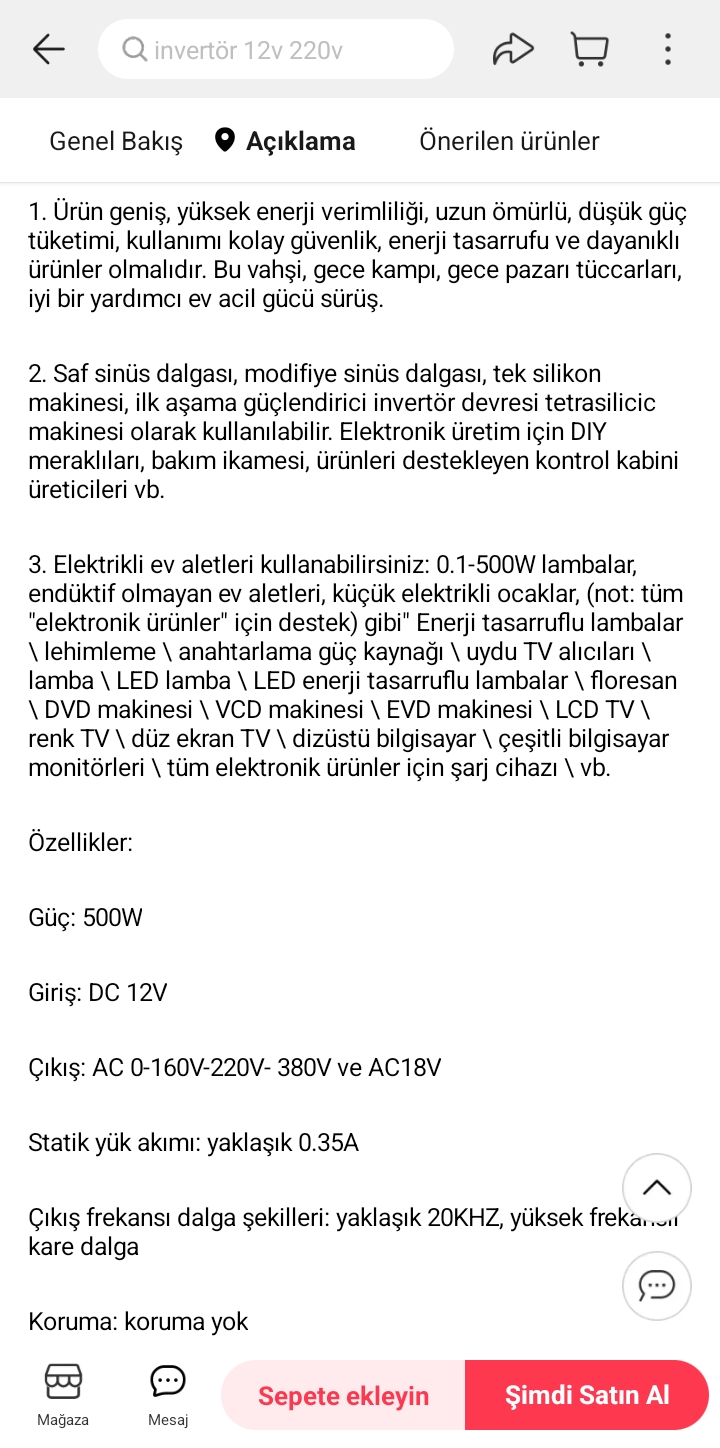

500w inverterin 60w da mosfet yanma sorunu
@serkan_48 inde bulduğu bilgilerin orjinalini amazon da buldum. Aşağıdaki metinde bulabilirsiniz.
Yalnız metin çin ingilizcesi ile yazılmış yani Chinglish ile (ingilizler bu tabiri kullanıyor)
4. Uyarya bakarsanız,
Çıkış yüksek frekanslı ve motorlar ve indüktif yüklerde kullanılamıyor.
Sonuç olarak çok basit devrelerin dışında ciddi dizayn isteyen devrelerde Çin malı kullanmayın
About this item
1. High energy efficiency, , low consumption, convenient and safe to , energy saving and durable, widely used in , night camps, night market vendors, driving and outage emergency helpers
2. It can be used as the front- boost inverter circuit of pure sine wave, modified sine wave, single-silicon machine, and four-silicon machine. For electronic enthusiasts DIY production, maintenance and replacement, manufacturers control cabinet supporting and so on.
3. You can electrical appliances: , non-inductive household appliances, small electric rice cookers, (note: support all ''electronic '') such as: energy-saving /solder/switching supply/satellite TV receiver/bulb/ LED lamp/LED energy-saving lamp/fluorescent lamp/DVD player/VCD player/EVD player/LCD TV/color screen TV/flat screen TV/notebook/computer/various computer monitors/all electronic charger /etc.
4. Notice: This board is a high-frequency wave AC output, so general inductive appliances cannot be carried! ! (Such as: electric motors, electric fans, coil , etc. cannot be used directly) Another: Simple -capacitance step- small electrical appliances, cheap -capacitance step- LED , etc. may not be used
5. Many multimeters output high-frequency -wave AC cannot measure or display low and high levels (it is incorrect, not the actual ) (can be measured by the multimeter in DC after rectification)
Devre üzerindeki trafo ferit nuve olduğunu görüyorum. Bu tür trafolar yüksek frekansta anahtarlanir. Çıkışın 50 hz olması için çıkışın dogrultulup yeniden 50 hz olarak anahtarlanmasi lazim.
Bu devre bu kadar komplike değil diye görüyorum.
Edit ; bu devreyi internette aradım bir satış sitesinde buldum. Aldığım ekran alintisi asagida ekliyorum.
Yine sitede cihazin induktif yüzlerde kullanilmamasini önermişler. Devrenin çıkış frekansını 20 khz karedalga olduğu yazıyor.
Aslında bu devre bir boost converter. Çıkışı 220 volt kullanımı için çok genel bilgilendirilmiş. 220 volt cihazlarda kullanmak için uygun görmüyorum. Ben olsam bu cihazi elektronik cihazlarimda kullanmam. Ekli dosyayı görüntüle 97849
