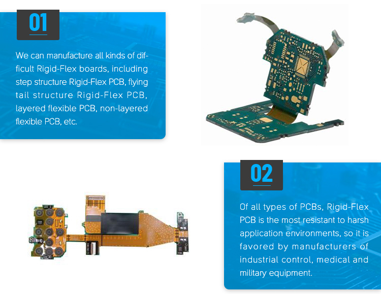

We can manufacture all kinds of difficult Flex Printed Circuit Boards and Rigid Circuit Boards , including step structure Rigid-Flex PCB.flying tail structure Rigid-Flex PCB.layered flexible PCB,non-layer edilexible PCB, etc.
Of all types of PCBs,Flex Printed Circuit Boards and Rigid Circuit Boards is the most resistant to harsh application environments, so it is favored by manufacturers of industrial control, medical and military equipment.

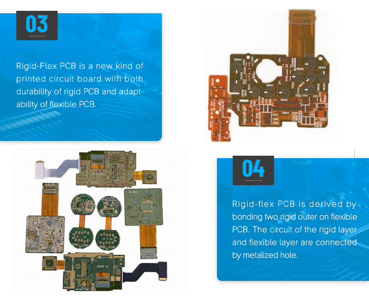

Rigid Circuit PCB Board is a new kind ofprinted circuit board with bothdurability of rigid PCB and adapt-ablity of flexible PCB.
Rigid Circuit PCB Board is derived by bonding two rigid outer on flexible PCB.The circuit of the rigid layer and flexible layer are connectedby metalzed hole.

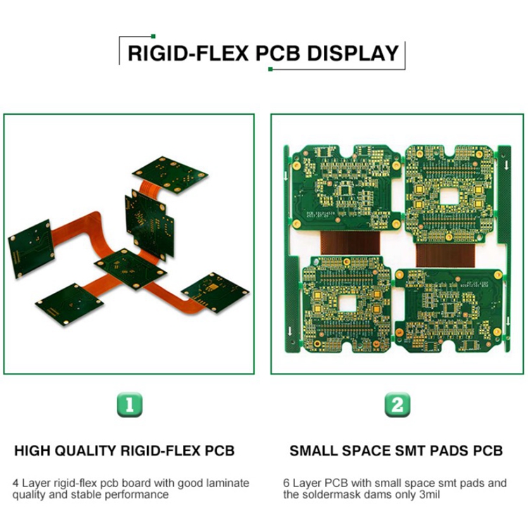

High Quality Flex Printed Circuit Boards and Rigid Circuit Pcb Boards:4 Layer rigid-flex pcb board with good laminat equality and stable performance.
Small Space SMT Pads Pcb:6 Layer PCB with small space smt pads and the solder mask dams only 3mil.

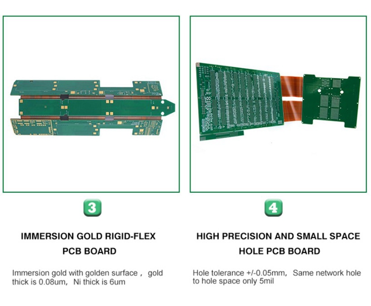

3 Immersion Gold Flex Printed Circuit Boards and Rigid Circuit Pcb Boards:lmmersion gold with golden surface , gold thick is 0.08um. Ni thick is 6um.
High Precision And Small Space Hole Pcb Board:Hole tolerance +/-O.05mm.Same network holeto hole space onlly 5mill.

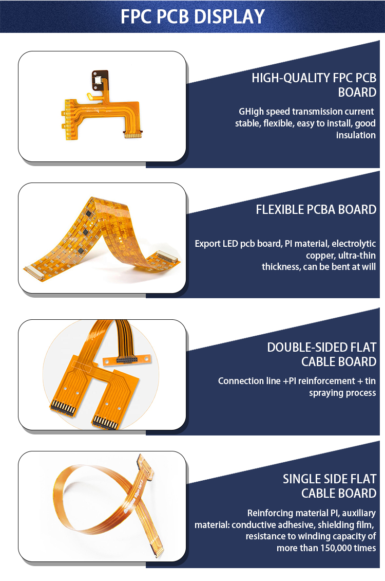

High Quality Fpc Pcb Board:with high speed transmission current stable,flexible,easy to install,good insulation.
Flexible Pcba Board:export led pcb board,PI material,Electrolytic copper,ultra-thin thickness,can be bent at will.
Double Sided Flex Pcb Manufacturer:connection line+PI reinforcement+tin spraying process.
Material: conductive adhesive, shielding film,resistance to winding capacity of more than 150,000 times.
