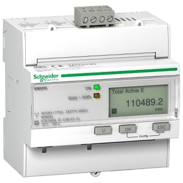

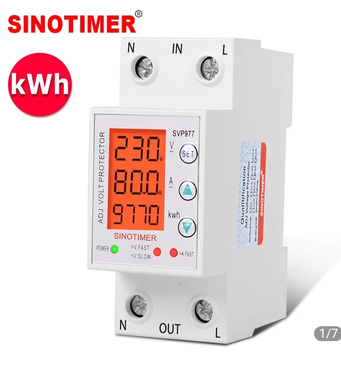

Hocam ben daha diyorum ülkemizede akıllı sayaçlar gelse keşke diye siz mekanik sayaç diyorsunuz. Kafanızdaki şüpheleri gidermek için elektrik panonuza bir tane ölçüm cihazı koyun ve her ay karşılatırırsınız. Aşağıdaki ürün hemen hemen KAR boyutlarımda.

https://tr.aliexpress.com/item/4000475871759.html?gatewayAdapt=glo2tur&spm=a2g0o.detail.1000013.1.740c55e30WEiJh&gps-id=pcDetailBottomMoreThisSeller&scm=1007.13339.169870.0&scm_id=1007.13339.169870.0&scm-url=1007.13339.169870.0&pvid=27d49caf-f5ab-4d1c-b182-c5a2cca4001b&_t=gps-id:pcDetailBottomMoreThisSeller,scm-url:1007.13339.169870.0,pvid:27d49caf-f5ab-4d1c-b182-c5a2cca4001b,tpp_buckets:668#2846#8108#1977&pdp_ext_f=%7B%22sku_id%22%3A%2210000001957970383%22%2C%22sceneId%22%3A%223339%22%7D&pdp_pi=-1%3B221.66%3B-1%3B-1%40salePrice%3BTRY%3Brecommend-recommend
https://tr.aliexpress.com/item/4000...%3B-1%40salePrice%3BTRY%3Brecommend-recommend

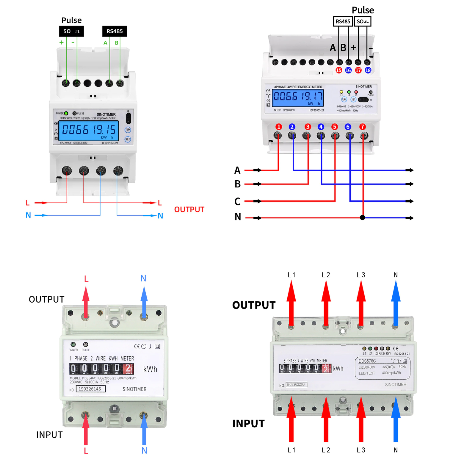

Mekanik isteyenlere .
https://tr.aliexpress.com/item/1005003288273820.html?gatewayAdapt=glo2tur&spm=a2g0o.detail.1000060.1.776f8ccax5pRKe&gps-id=pcDetailBottomMoreThisSeller&scm=1007.13339.169870.0&scm_id=1007.13339.169870.0&scm-url=1007.13339.169870.0&pvid=fe74f663-43ad-4012-8653-3c8c10f69ca4&_t=gps-id:pcDetailBottomMoreThisSeller,scm-url:1007.13339.169870.0,pvid:fe74f663-43ad-4012-8653-3c8c10f69ca4,tpp_buckets:668#2846#8108#1977&pdp_ext_f=%7B%22sku_id%22%3A%2212000025034787960%22%2C%22sceneId%22%3A%223339%22%7D&pdp_pi=-1%3B75.75%3B-1%3B-1%40salePrice%3BTRY%3Brecommend-recommend
https://tr.aliexpress.com/item/1005003298498263.html?gatewayAdapt=glo2tur&spm=a2g0o.detail.1000013.11.1e1d7fc1wLi7GF&gps-id=pcDetailBottomMoreThisSeller&scm=1007.13339.169870.0&scm_id=1007.13339.169870.0&scm-url=1007.13339.169870.0&pvid=9f0b7344-bd9a-4e7a-943c-141c12456420&_t=gps-id:pcDetailBottomMoreThisSeller,scm-url:1007.13339.169870.0,pvid:9f0b7344-bd9a-4e7a-943c-141c12456420,tpp_buckets:668#2846#8108#1977&pdp_ext_f=%7B%22sku_id%22%3A%2212000025083360208%22%2C%22sceneId%22%3A%223339%22%7D&pdp_pi=-1%3B213.54%3B-1%3B-1%40salePrice%3BTRY%3Brecommend-recommend
