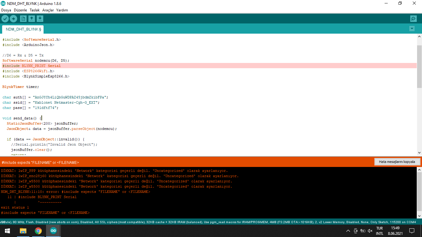

#include BLYNK_PRINT Serial

void loop() {
Blynk.run();
timer.run();
dht11+uno==> nudemcu ==>Blynk
Arkadaslar bu hatayi niye aliyorum acaba.. duzeltme yolu varmidir
Simdiden tesekkurler....
Blynk ile hicbir komut girmeden once seri iletisimde hicbir sikinti yok...ama blynk isin icine girince bir turlu asamiyorum...
Arkadaslar sorunu cozdum...
isine yarayan olur diye kodlari asagi yaziyorum..
AKIS=
dht11 arduino uno ya bagli
nudemcu seri iletisim(rx-tx)ve toprak hatti (gnd-gnd) ile uno ya bagli
Blynk yazilimi ile heryerden sensor verilerini okuyabilirsiniz..
asagidaki program ile degisik versiyonlar yapabilirsiniz...
//ARDUINO ya YUKLE
//DHT11 Lib
#include <DHT.h>
//Arduino to NodeMCU Lib
#include <SoftwareSerial.h>
#include <ArduinoJson.h>
//Initialise Arduino to NodeMCU (10=Rx & 11=Tx)
SoftwareSerial nodemcu(10, 11);
//Initialisation of DHT11 Sensor
#define DHTPIN 2
DHT dht(DHTPIN, DHT11);
float temp;
float hum;
void setup() {
Serial.begin(9600);
dht.begin();
nodemcu.begin(9600);
delay(1000);
Serial.println("Program started");
void loop() {
StaticJsonBuffer<1000> jsonBuffer;
JsonObject& data = jsonBuffer.createObject();
//Obtain Temp and Hum data
dht11_func();
//Assign collected data to JSON Object
data["humidity"] = hum;
data["temperature"] = temp;
//Send data to NodeMCU
data.printTo(nodemcu);
jsonBuffer.clear();
delay(2000);
void dht11_func() {
hum = dht.readHumidity();
temp = dht.readTemperature();
Serial.print("Humidity: ");
Serial.println(hum);
Serial.print("Temperature: ");
Serial.println(temp);
//NODEMCU YUKLE
#define BLYNK_PRINT Serial
#include <ESP8266WiFi.h>
#include <BlynkSimpleEsp8266.h>
BlynkTimer timer;
char auth[] = "bylink kodunu yazin";
char ssid[] = "ssid adini yazin";
char pass[] = "ssid sifresini yazin";
//D8 = RX & D7 = TX
SoftwareSerial nodemcu(D8, D7);
void send_data() {
StaticJsonBuffer<200> jsonBuffer;
JsonObject& data = jsonBuffer.parseObject(nodemcu);
if (data == JsonObject::invalid()) {
//Serial.println("Invalid Json Object");
jsonBuffer.clear();
return;
Serial.println("JSON Object Recieved");
Serial.print("Recieved Humidity: ");
float hum = data["humidity"];
Blynk.virtualWrite(V0,hum);
Serial.print("Recieved Temperature: ");
float temp = data["temperature"];
Blynk.virtualWrite(V1,temp);
Serial.println("-----------------------------------------");
// ================= SETUP =============================
void setup() {
// Initialize Serial port
Serial.begin(9600);
while (!Serial) continue;
Blynk.begin(auth, ssid, pass,"blynk-cloud.com", 8080);
timer.setInterval(100L, send_data);
void loop() {
Blynk.run();
timer.run();
